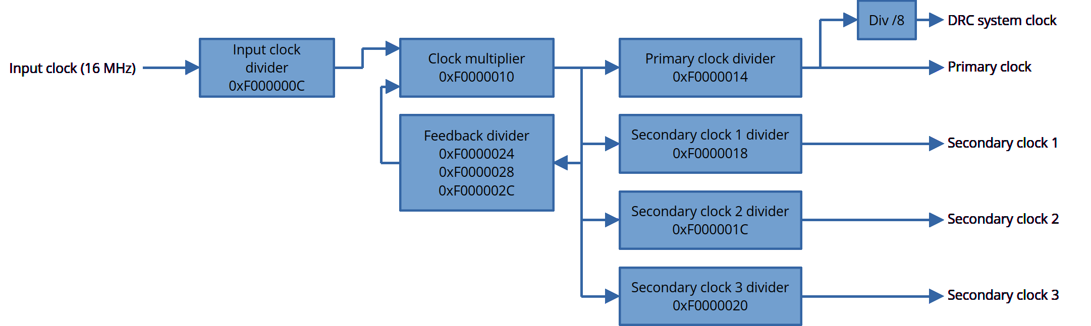

PLL
The gamepad starts at a clock of 16 MHz. PLL settings applied by the second stage bootloader change the system clock to 108 MHz.
Different settings are applied based on the base clock.
| Setting | 16 MHz value | 24 MHz value |
| 0xF000000C | 13 | 20 |
| 0xF0000010 | 0x5E8000 | |
| 0xF0000014 | 5 | |
| 0xF0000018 | 510 | |
| 0xF000001C | 108 | |
| 0xF0000020 | 510 | |
| 0xF0000024 | 0xBC | |
| 0xF0000028 | 0x24 | |
| 0xF000002C | 0x3A1 | |
TODO: not known yet how the control registers work, ie. how to actually apply PLL settings
The base clock is divided by the input clock divider, then multiplied by the clock multiplier, producing a VCO frequency of 1728 MHz.
This frequency is then fed into 4 separate dividers to produce the primary clock and 3 secondary clocks. The primary clock is then divided by 8 to produce the DRC system clock.
The feedback frequency generation is not completely understood yet.
0xF000000C
Input clock divider. This register is 6 bits wide.
This seems to be a count-up divider, ie. setting it to 13 divides the input clock by 14.
0xF0000010
Clock multiplier. This register is 26 bits wide.
Bits 0-11 seem to be the fractional part of the multiplier.
0xF0000014
Primary clock divider. This register is 9 bits wide.
Possible values:
| Value | Divider |
| 0b0'0000'0000 | 4 |
| 0b0'0000'0010 | 4 |
| 0bx'xxxx'xxx0 | Register value |
| 0b0'xxxx'xxx1 | 2 |
| 0b1'xxxx'xxx1 | 2.5 |
This is a weird kind of divider: if bit 0 is set, the input is divided by 2 or 2.5 (depending on bit 8), but if bit 0 is cleared, the input is divided by the register value. Values 0 and 2 behave the same as 4.
It also appears that 2.5 isn't supported for the primary clock, and acts the same as 2?
0xF0000018
Secondary clock 1 divider. Function same as 0xF0000014.
0xF000001C
Secondary clock 2 divider. Function same as 0xF0000014.
0xF0000020
Secondary clock 3 divider. Function same as 0xF0000014.
0xF0000024
This register is related to the feedback frequency generation. This register is 12 bits wide.
0xF0000028
Needs to be set to a nonzero value.
0xF000002C
This register is related to the feedback frequency generation. This register is 26 bits wide.
This register is related to 0xF0000028 in that one unit of 0xF0000028 equals 512 units of 0xF000002C.
